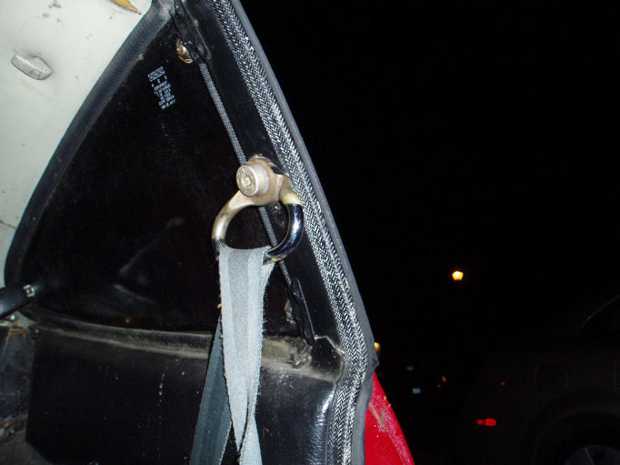

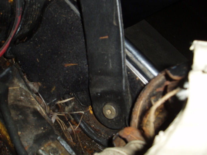

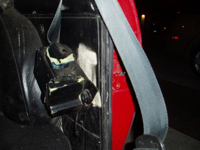

Most Helpful Answer - Posted by First opel 1981
Clarifying.
It's not just the post anchor that is added. That is what makes it a shoulder belt.
There is also the recoil that sits next to the rear inner wheel well.
And the main anchor is down by the seat pivot.
And no picking on the condition of the car. Haven't started cleaning it up yet.

Clarifying.
