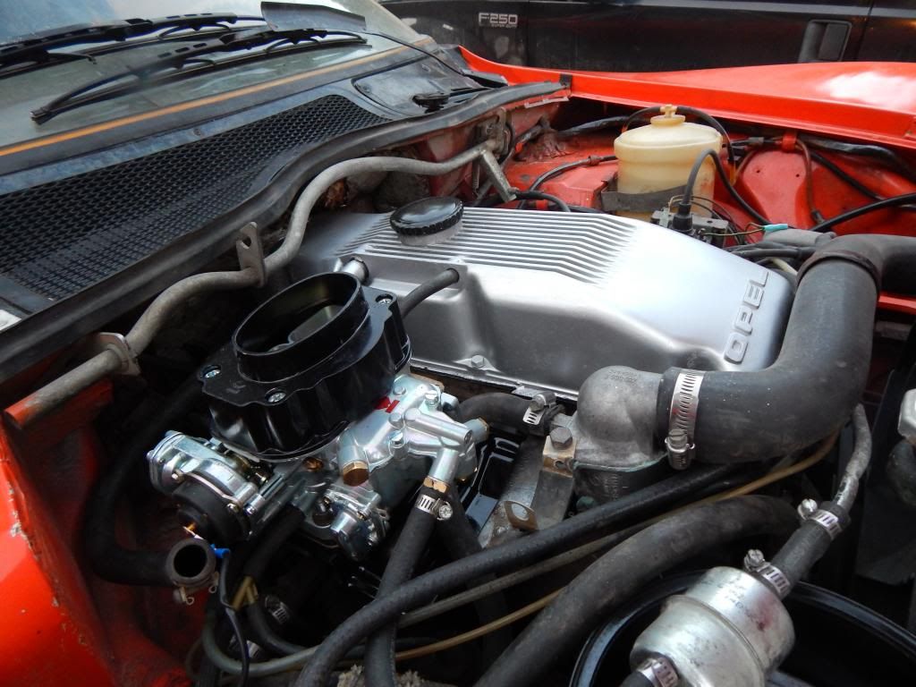

    Vivian breathes again!! I started her up today after her two year sleep and boy did she purr. I am gonna use this thread for all of the work I do to her. So far she has a new Weber 32/36, new plugs, wires, cap and rotor.
    I cleaned up the engine by degreasing it and painting the valve cover. I am going to clean and paint everything as I go through it. I took off the entire air assembly and painted it gloss black.
    But here is my first question for all of you. I put the 1/4" phenolic spacer between the car and heat shield. Then I am using the ogts weber to stock air cleaner assembly adapter. My problem is the carb assembly is now too tall for the hood to close. Here is a picture.

    Who else has run into this and what did you do? I think if I trim about 3/4" out of the air hat that goes on top of the carb it may fit, but I don't wanna cut it till I hear other options.
    Here is the setup without the hat that I plan on trimming.

    That is what I did when I threw away the solex and put that set up on my 72 GT, and it still would rub the hood a little when the motor torqued.

    belt sander may work.

    It seems your adapter is the problem. OGTS sells one thats much shallower and fits over to the stock air filter.nice car

    I did like alot of others has done.
    5.25 with a cry-sler bonnet

    @dsmith -- So if I am correct you successfully trimmed down the air hat the goes on top and attaches to the hose? If that works, out comes my dremel.

    There are a few options. You can acquire another air cap, one that you can experiment with trimming and so you can retain your original air cap as it is. There's one on Ebay selling cheap right now. Or you can purchase a Weber air filter kit with a 1" shorter element.
    If finances aren't a concern the full dome kit will not only provide better clearance but will also provide cooler air to your carb too.

    Same here. Some rubbing at first, but taking a bit more off fixed that.

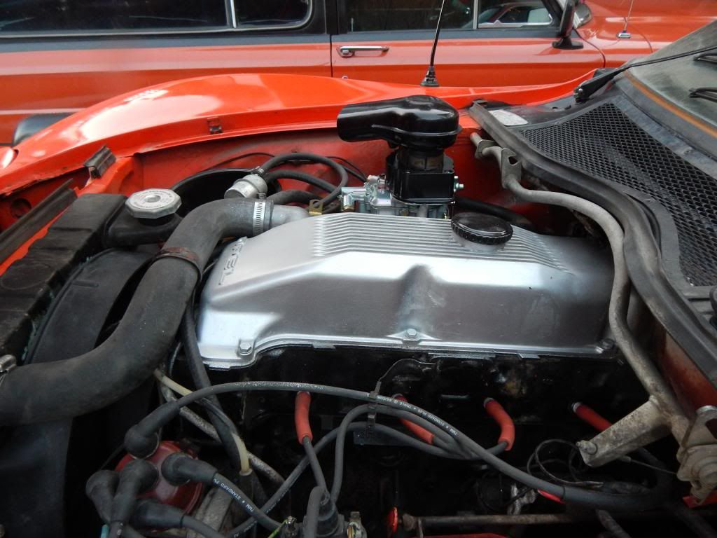

    Today I trimmed about 3/4" off the base of the air hat and now it fits like a glove. Whole air intake is cleaned painted and re-installed.
    So now problem number two. She was on the trailer and I decided it was time to come on down. She fired right up and sounded great, revving to 3000 rpm no problem. As I put her in gear she started to sputter and die. I looked and the dizzy had turned a little. I reset it and tightened it down. She fired right up and I backed her off the trailer and boom, she died. Now I can't get her to start again. Totally sounds like an ignition problem to me. I looked inside the cap and saw a little ground wire that goes from the base of the points to the wall is toast. Then I pulled the lead off the coil and it was all wet. I am guessing this is a bad thing.
    I played with the timing a bunch and still no go. Good thing my pertronix ignitor and coil showed up today. Im gonna push her in the garage and I will switch out the ignition and let you know.
