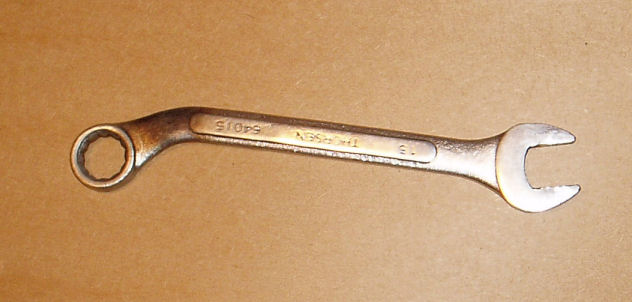

  13. #33
    Stupid Question!
    What is this? (GT)

    Quote Originally Posted by MonkeyNutZ View Post
    Stupid Question!
    What is this? (GT)
    I've never seen one but based on where it is and the vacuum connection I would say it is an EGR Valve
    Jeff
    Stupid Question!
    What is this? (GT)
    Catalytic converter coupler? I recall seeing one of those once and it's stuck in my head that it went to a prehistoric version of a catalytic converter.

    Quote Originally Posted by First opel 1981 View Post
    Nope, no cats on the GT's, the short connection on the unit goes into the base of the intake manifold and I assume the longer end must have gone either to the exhaust system or the crankcase ventilation system. I am sure someone who really knows will pipe in here.

    Its an EGR valve.

    Quote Originally Posted by markandson View Post
    The only other Opel I owned was a 74 Manta. I ended up taking that engine out and putting it in GT#6.
    If that thing I remember wasn't in the 74 Manta then I don't know what it was in. Maybe a 74 Vega?
    OK, it's official. I'm getting old. I can't remember SHtuff.
    It's quite possible it came out of a 74 vehicle, the first year they started that kind of junk was '73 and in '74 they started using air pumps and stuff like that. I have one of those short pieces that someone cut and plugged, obviously to get rid of the EGR system.
