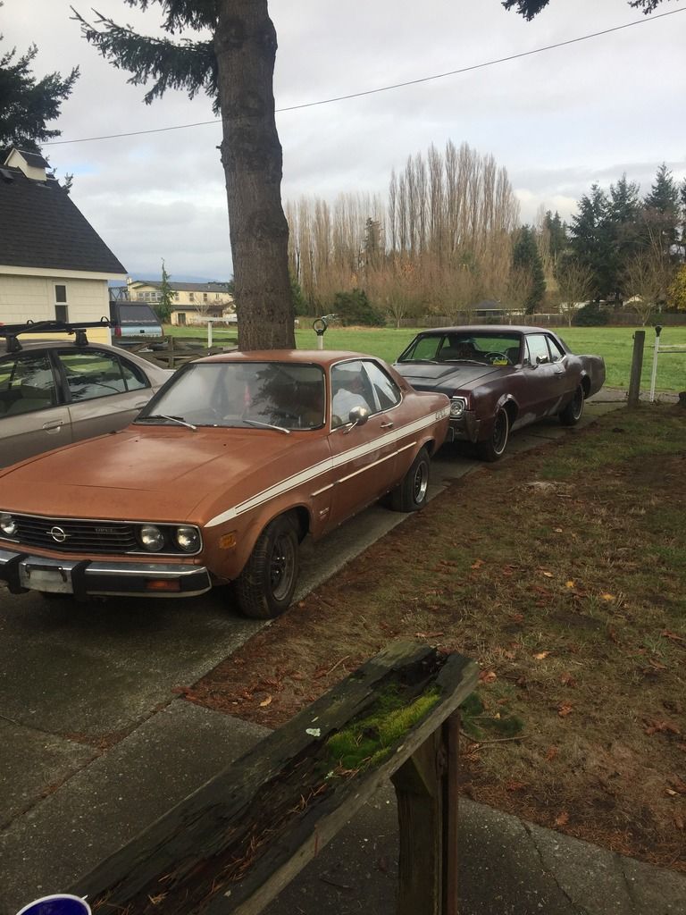

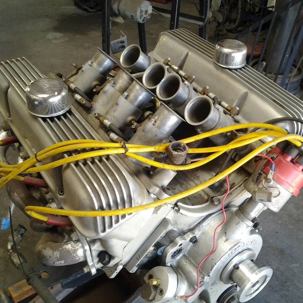

I bought my 75 manta so I had a car to put this in.
But I planned to get the car running and drive it as is while I fuel injected my olds, but the cam went flat in the 1.9 so now plans have changed. I don't want to put anymore money into the 1.9 since I plan on pulling it anyways, so I decided to move the v8 swap up the list so I'll have a car to drive while I convert the olds to efi. I'm not putting the engine shown in right away, needs work, but I have another 215 I'll put together for it. Anyway here's a pic of the manta and the olds, I'll keep you guys updated on the swap

The engine I'll initially swap in I pulled out of a 62 f85 2bbl 3 on the tree car. I have a cam, performer intake and heads to bump the compression up, should be right around 200hp. Idk what tranny I'll run yet, I have a t50 but I want to put a rebuild kit in it and I can't find one.

I haven't committed to anything yet, still researching and planning stages. I've researched the spica set up that fiat used as well as Rochester and Bosch mechanical fuel injections
