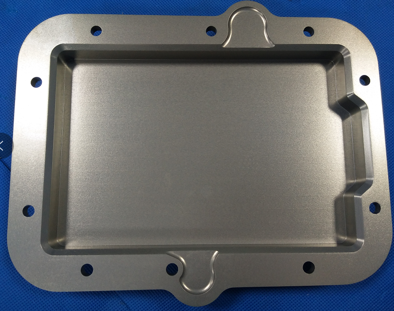

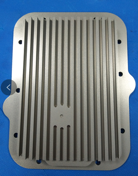

After fighting for too long to get my factory stamped pan flat and non-leaking I finally just decided to bite the bullet and design up my own aluminum one. Is there any interest in more? I have my first batch coming soon. It's made from 6061, shot-peened and hardcoat anodized aluminum. Guaranteed to be flat and compatible with standard gaskets. It is finned, has extra fluid capacity and is even pilot pointed for a drain plug or magnetic drain plug if you want. Pricing varies with qty's we get but it would be something like:
5: $175 + shipping (probably a flat-rate USPS box @$13
10: $150 + Shipping
Delivery would be EARLY January
Reply here for more info or PM me if you want to commit to one!

Since you’re still in the design stages, I’d recommend one change. Put the drain plug at the right rear corner of the pan. There’s a significant engine/tranny tilt rearward and sideways, so if you use a centrally located drain plug, you’ll leave a lot of gear oil behind.

Finally got around to getting under the car and putting this on. I did drill-n-tap for a magnetic drain plug too. Everything fit great! I'll take a look at Bob's suggestion of moving the drain hole, at the very least I'll be able to move it back TOWARDS that corner, not sure i'll be able to get it on the corner like his. Trying to keep it to a 1" nominal plate thickness. I'll post a design update when I move it but it looks like I'll be able to move 10 of these. For those interested in buying one, would you want the hole pre drilled and tapped for a standard drain plug?

OK I made the few changes I wanted from my first one. Mostly minor details like adding chamfers and such but also the big one of moving the drain hole rearward and pre-tapping for m14x1.5.
