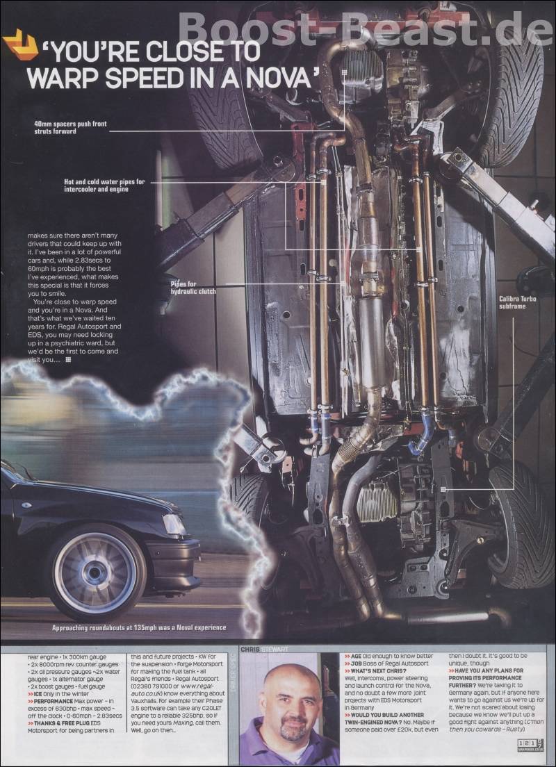

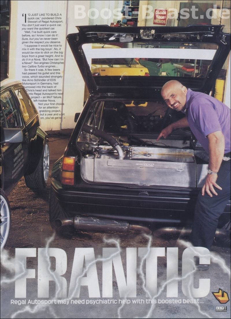

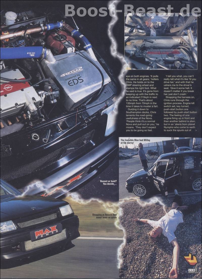

Am I right in believing that when you say MidEngined, you mean placing the Engine transverse in the rear of the GT?
If thats the case, I think you'd better look at this, If it can be done in the rear of a Nova, the same technique and subframe could be used easily in the GT.
Why reinvent the wheel when you can just rip off someone elses idea. ;)
The ecotec engine is the same as the C20LET engine in this conversion, I have to admit that I also toyed with this idea before but couldn't bring myself to have no engine in the front or wanted a transverse engine in the front of the GT to make it twinengined.
But if your asking me if its possible .... Well everythings possible, But would you really want to do it.
Enjoy the reading.
Boost Beast Page 1
Boost Beast Page 2
Boost Beast Page 3
Boost Beast Page 4
Boost Beast Page 5
