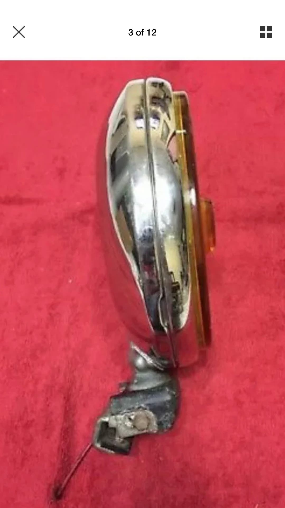

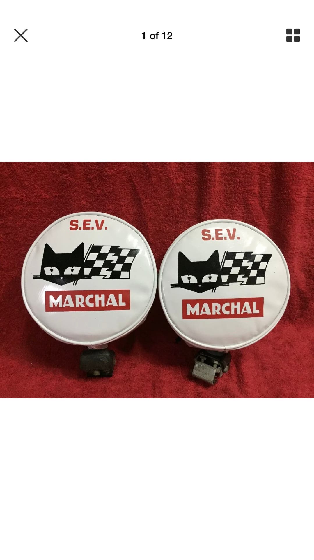

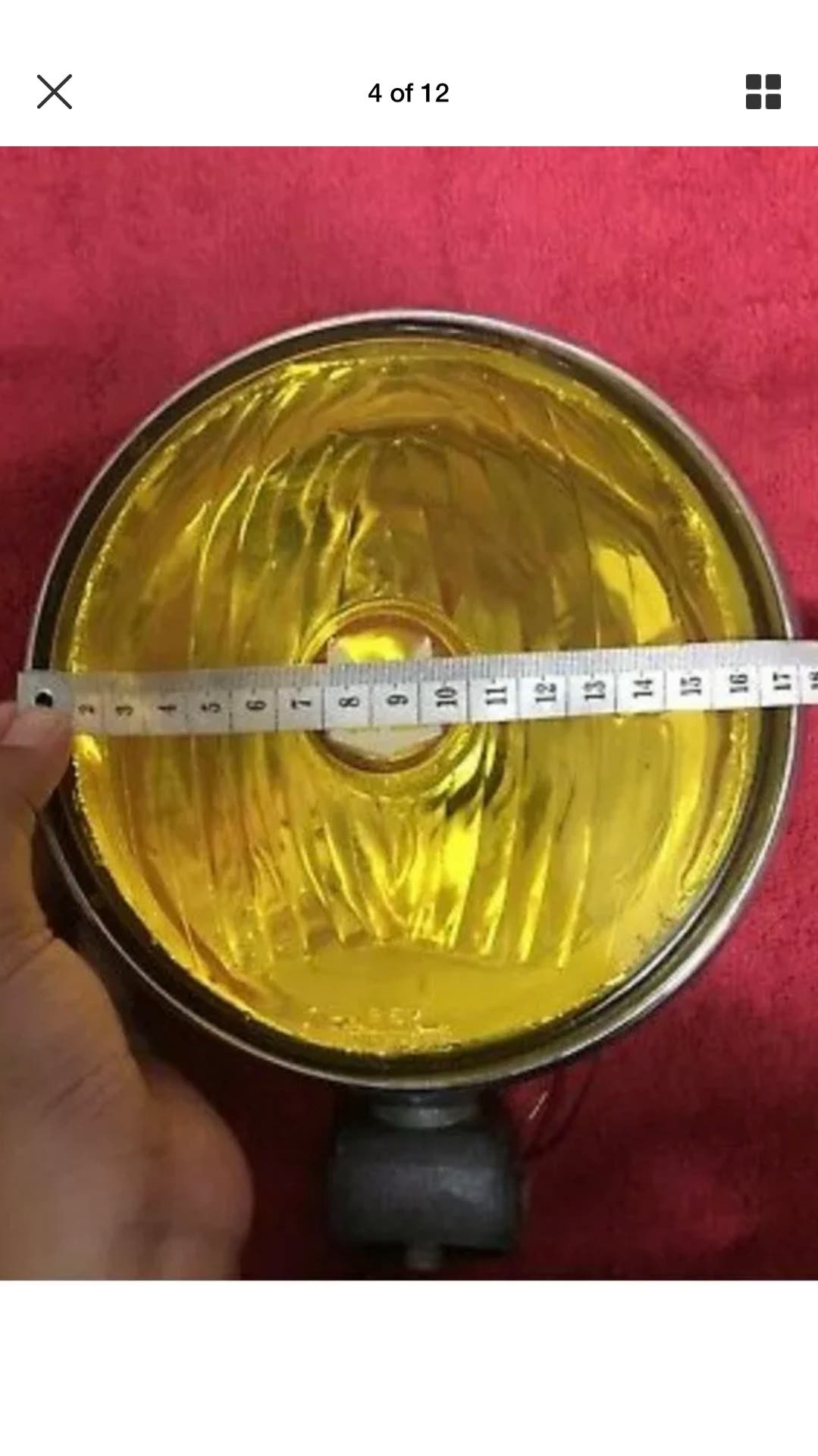

Don’t know if I can make this work or not but: I just purchased a pair of vintage SEV Marchal fog lights on eBay. It was a really low ball offer (made on a lark not really knowing what I was going to do with them - but I really liked them)....and I got it. Now what? 2 obvious questions.
1. Where can I place them? (I had been going over a ton of Opel GT rally and race images from Europe and only one position I like is on either side of the front license plate holder).
2. How am I going to wire them up? As in where should they connect on the fuse panel.

I use to have that type. You can still buy the yellow tinted bulbs.
