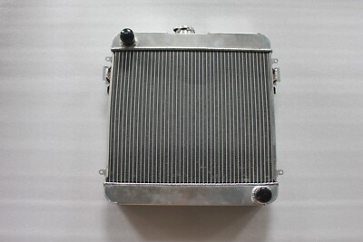

Are the ones from Winner real similar to the Honda ones? The mounts are correct but, for a Manta, I thought that they take some sort of alternate or revised upper radiator hose. Maybe from the GT?

Update on Coolex:
I have been in communication with Coolex and sent them pictures of my original radiator.
They sent back pictures of a correct configuration replacement radiator with the bottom outlet in the correct place (side) and all correct mounting tabs. They do place the radiator fill in the center at top of tank. Has anyone had hood fit issues with the radiator fill in the center? Seems center would be better location but then again why did Opel put it where they did to begin with? Seem Coolex would modify this if needed, interesting.
Confirmed, original has bottom side exit hose and car is a manual.
If hood fit is not an issue I may go with the Coolex vs. Winner due to the # sold, recommended by OGTS, have a good reputation and are communicating.
Original Radiator:
432914
Coolex Replacement (revised):
432915
Thoughts / Comments?
Easier to fill, if the hood opens to the front of the car and if the hood opens to the back in the center.
I am not sure anyone can tell you if they have had clearance issues as there may never have been a top cap rad made for these cars.
Here is pix of the fit in my Ascona, which is the same fit-up as the Manta A. I stuck my arm under the hood and took this with the hood still up 3-4" in the back. You can see the bracing under the front edge of the hood is getting close to where a center cap would go, and it will get another 1/2" or more closer with the hood fully closed. So the center cap in the Coolex pix could well be a problem; it's gonna be close. The stock rads had a depression in the center of the top tank, almost like Opel considered a top center cap but abandoned the idea.
Dropping the rad's position in the Manta/Ascona A is not a snap by any means, as the bottom biscuit mounts to a reinforcement on the front valence. I have dropped a rad maybe 1/4" by changing the biscuit.
BTW, just in case, don't let them drop the height of the top tank to make more clearance. They probably would shorten the core first but just know that the upper tank is also the expansion reservoir in these older systems without a coolant recovery setup.

BTW.... Putting the fill down on the side has the benefit of not allowing you to overfill the top tank. That is necessary in an older type non-coolant recovery system; there has to be an air gap at the top of a certain size in that type of system. If you overfill it, then coolant just blows out the overflow tube as needed to force the necessary air gap in the top tank when cold.
Makes me wonder how Coolex has that top center neck set up... for a coolant recovery system? You ought to ask if you go with the the top cap. IIRC, I think that the cap is what changes between a coolant recovery system setup and one that is not, but I just can't recall 100% at the moment.

Purchased the radiator from Winner Racing as suggested:
Discovered that the one from Coolex is for a Manta B.
